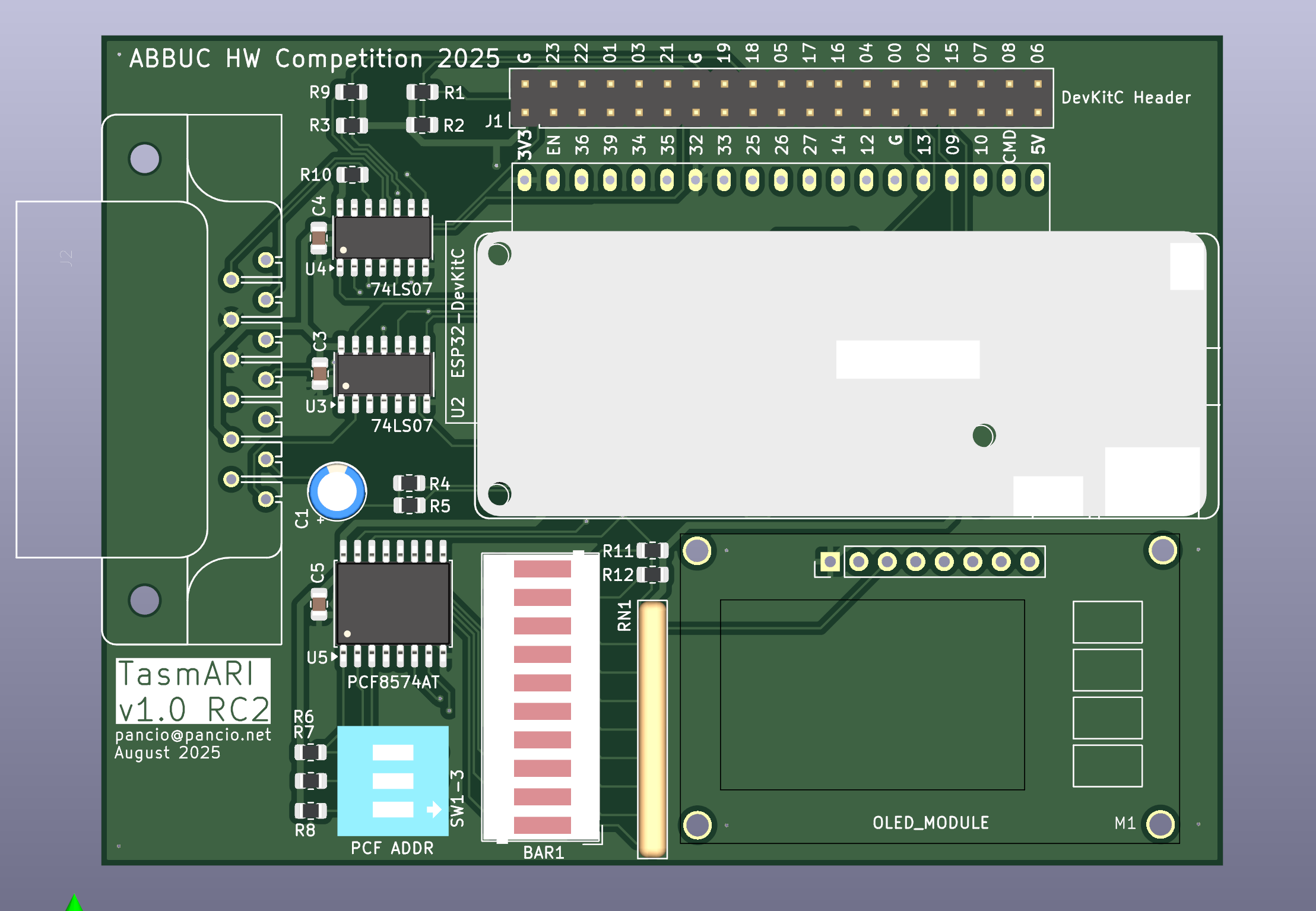

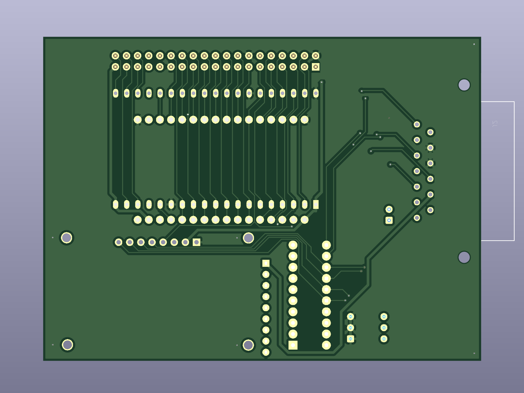

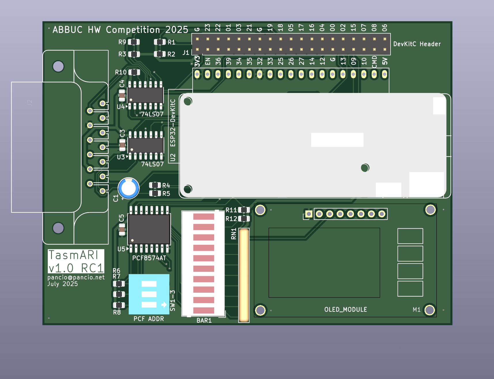

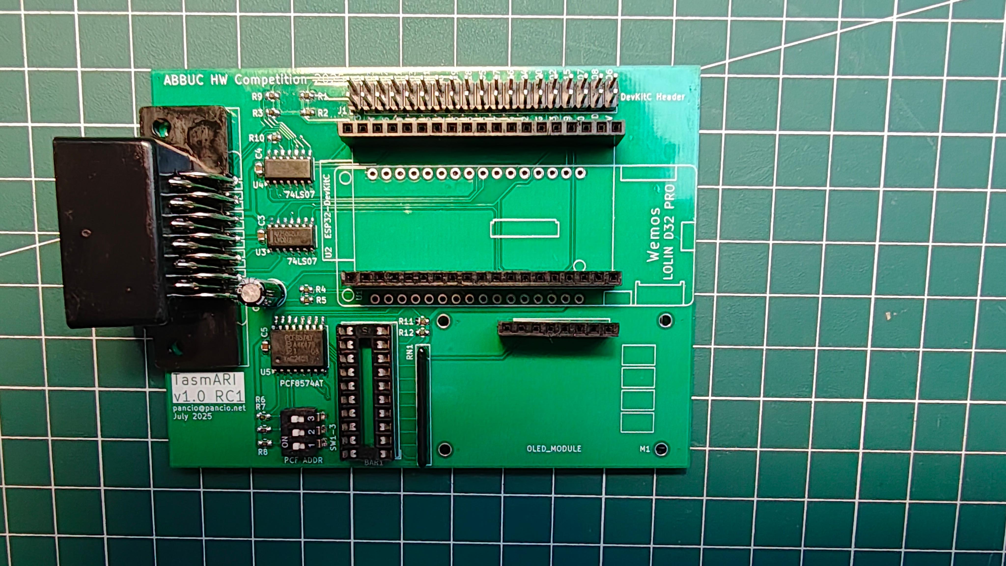

PCB-Visualisierung erstellt in KiCAD:

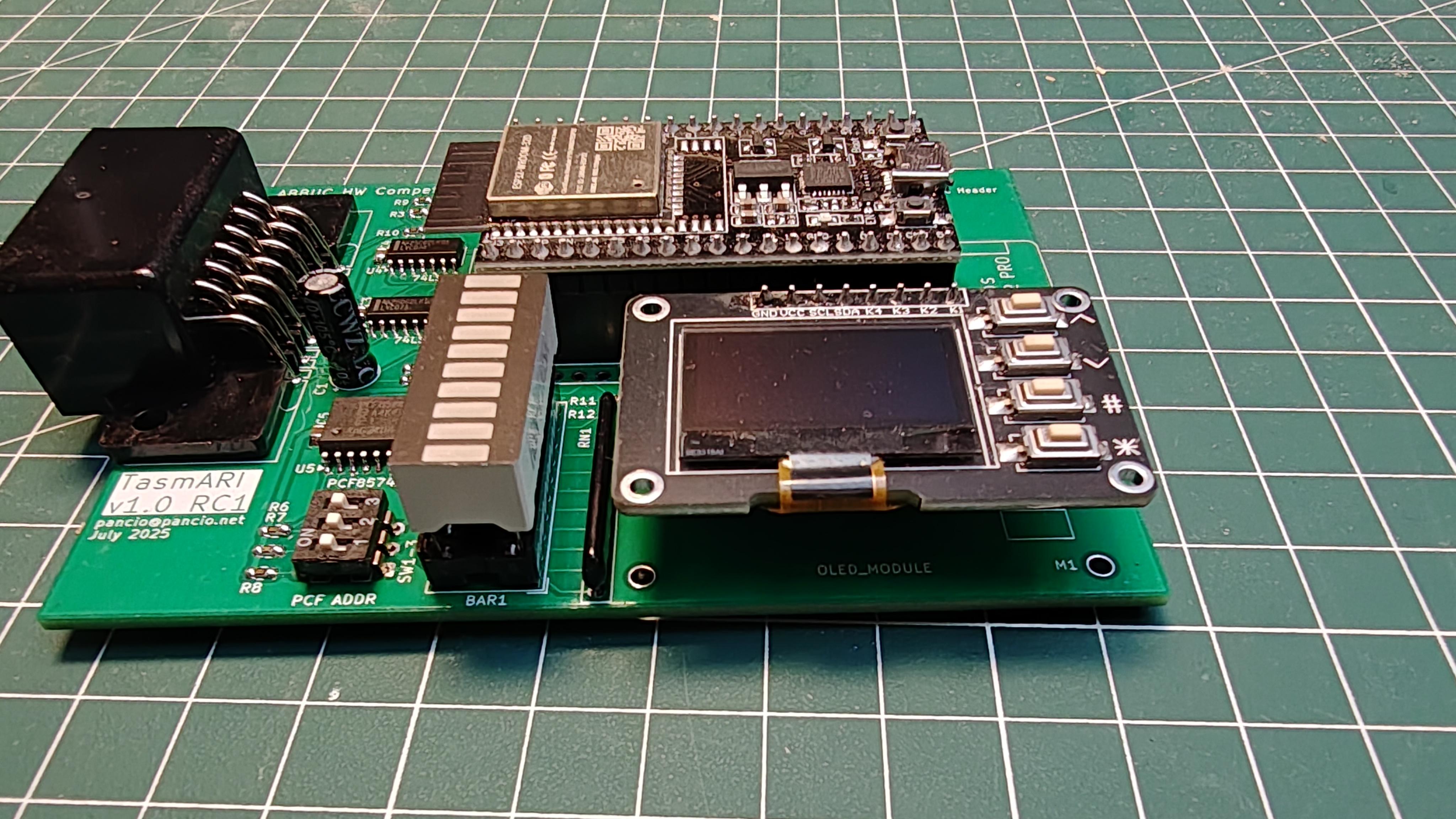

Und die fertige Prototypplatine, gestern geliefert und schnell zusammengebaut:

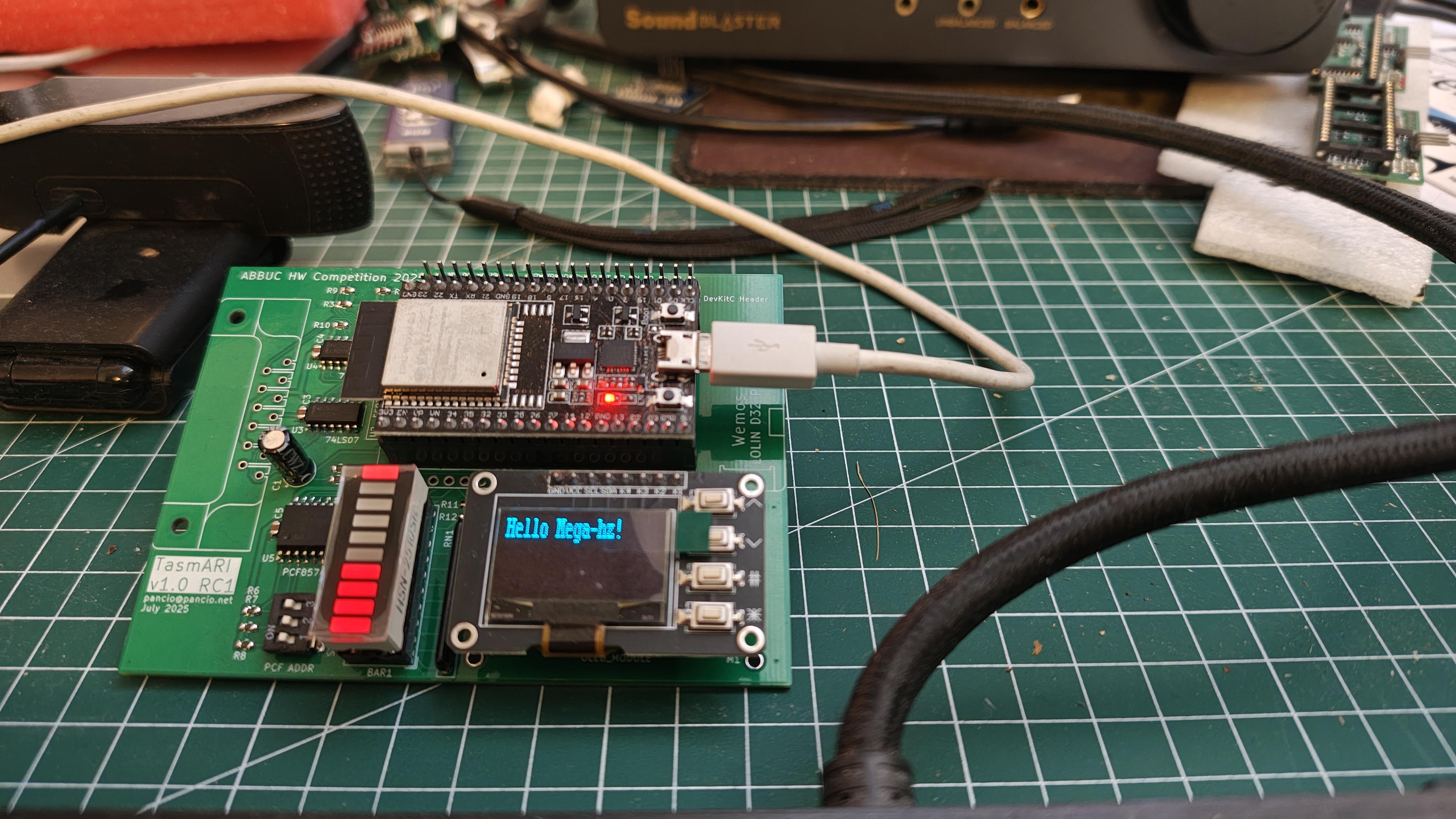

Erster Test (ohne Atari)
Ich plane, dieses Wochenende mit den Tests zu beginnen!
Br, pancio
The silent hero of the episode are: strapping pins :-)

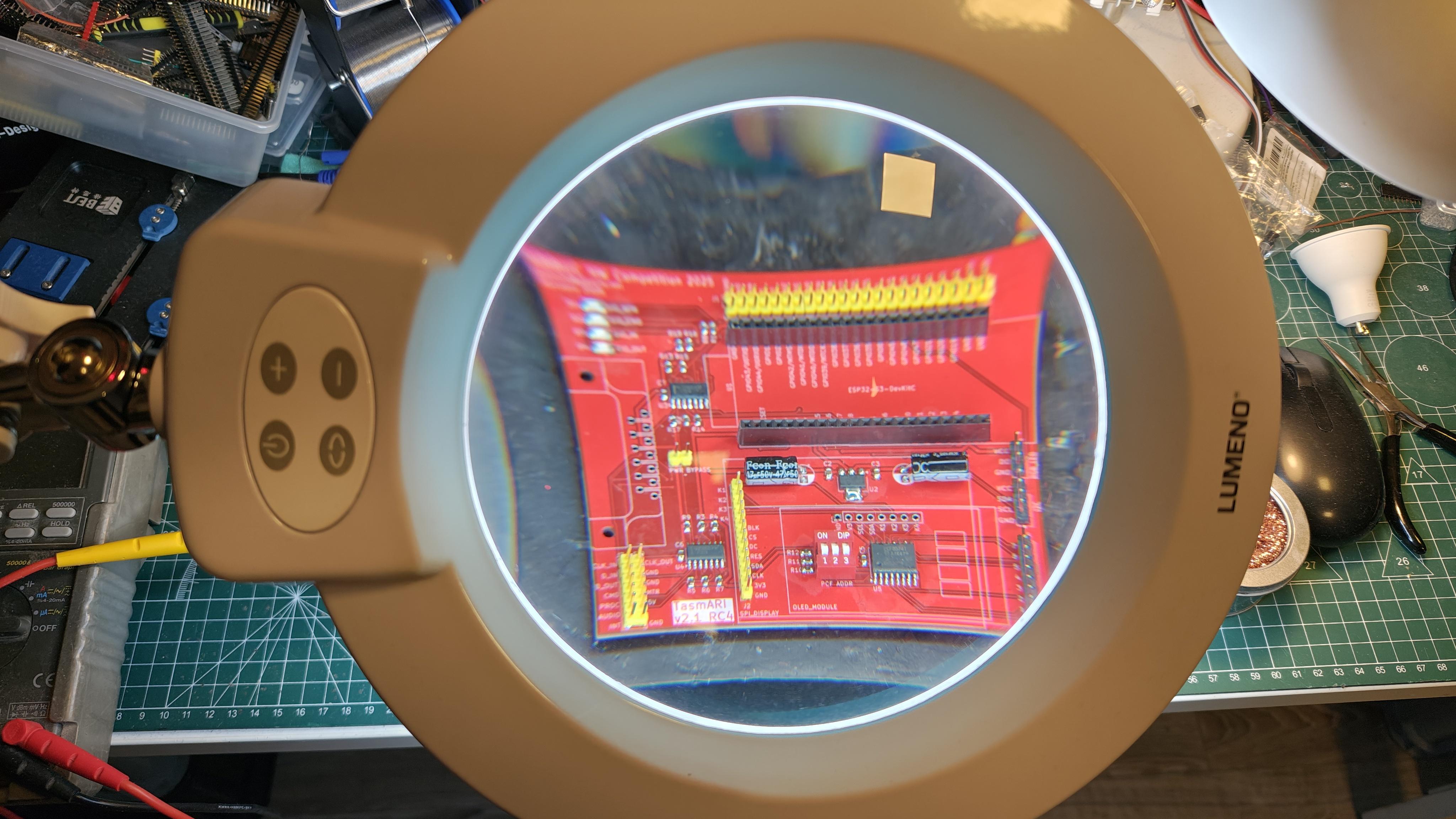

I didn't manage to accomplish much with the project, but I'd like to share a few conclusions and discuss a few problems I encountered during implementation. The first Tasmari RC1 board was a bit disappointing because I didn't anticipate that the ESP32 had several strapping pins, the state of which affects how the ESP32 boots. I supposedly knew this beforehand, but somehow I overlooked one of them, and my Tasmari wouldn't boot correctly. Of course, I managed to get the board working (I had to cut and rewire a few traces), but I still had to redesign the circuit. That's how the RC2 version was born...
The board arrived a week later, and I assembled two of them at once. I was very surprised that the new version wouldn't start again... It turned out that while swapping several GPIOs, one of the strapping pins was being forced into an incorrect state by the Atari's PROCEED signal. The solution was to cut the trace and remove the signal... The module booted.
So, success! But not entirely :-)

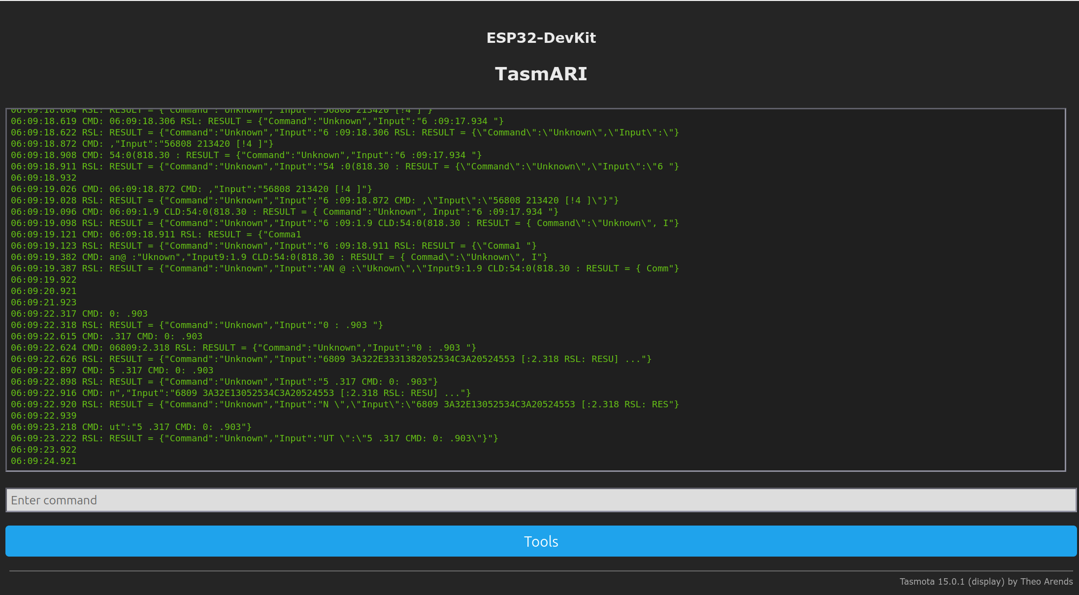

The principle I adopted for communication between Atari and Tasmota OS is very simple: a simple program in Berry listens on the serial port and everything that comes in is interpreted as a command for Tasmota. This time, the Tasmota operating system surprised me... it turns out that in serial-bridge mode, which is used for communication between the Atari and Tasmota OS, it intercepts and attempts to execute everything that appears on the console, while I assumed these would only be messages coming from the Atari. Interestingly, when I use the ESP32 module without the Tasmota PCB, the problem doesn't occur! I again began to suspect strapping pins.
It also turns out that the problem disappears after 10 minutes and the Atari can take over communication with Tasmota OS! That's a clue – I already know that logging from the serial port can be disabled via the SerialLog option, but it's not very pretty... I'll have to look into this a bit more.

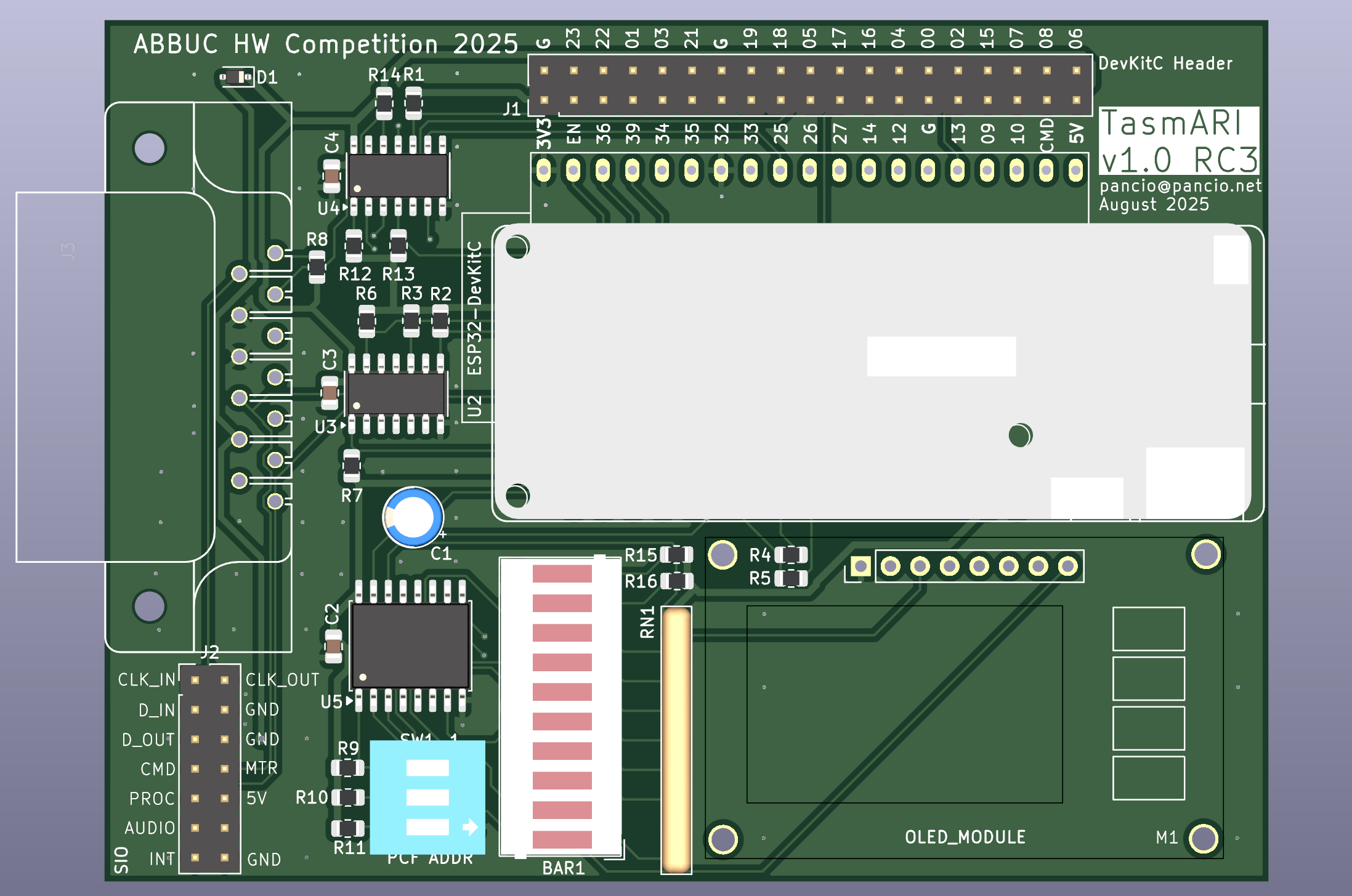

After reading a few pages of the ESP32 documentation, I rebuilt the wiring diagram, added some pull-up resistors, designed the RC3 version, and am waiting for the boards – they should arrive this week. We'll keep fighting :-)
Oh! I forgot to mention what other difficulties I encountered... anyone who has ever tried to insert a Sikor SIO socket will understand! THESE ARE NOT SOCKETS FOR NORMAL PEOPLE! :-) It's so difficult to insert into standard PCB holes that after the entire operation, I had cut my hands and damaged two SIO sockets (and they're not cheap!). So, I decided to add a standard pinheader to the RC3 version to make it easier to check the SIO pins and also to save on the expensive Sikor SIO sockets...

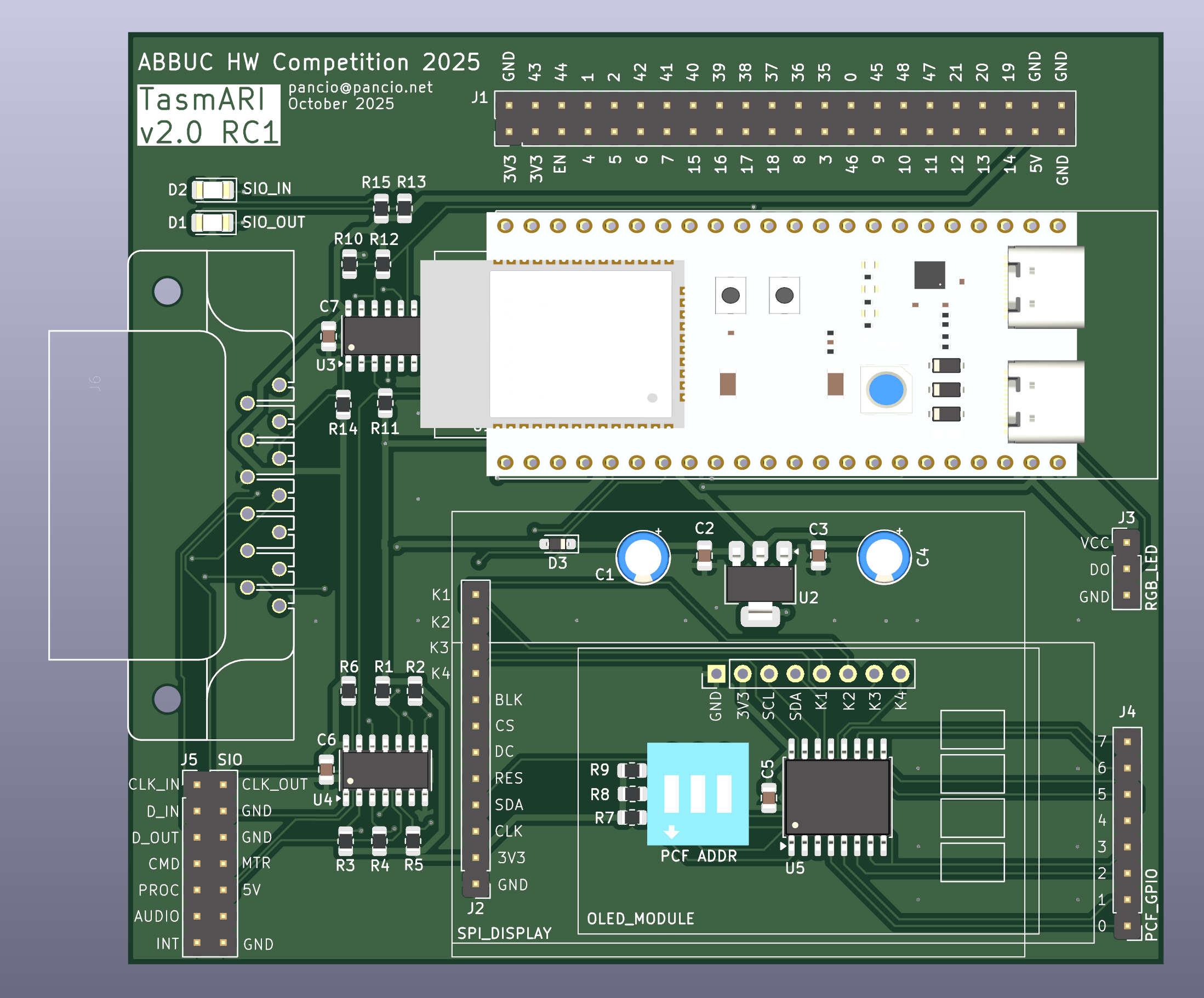

Just a quick update today regarding the change in the execution module. I decided to use the ESP32-S3, which has more features – especially more GPIO pins, which aren't specifically assigned to specific functions like the basic ESP32. The ESP32-S2 allows for greater operational freedom and easier development. Unfortunately, there's also a downside: the ability to play Atari sounds via the SIO_AUDIO input is gone (the ESP32-S2 doesn't have DACs). I'm not worried about this, though, because I can always add an external DAC via the I2S bus – which I'll do if the prototype works :-)
The current PCB is designed to support three different displays (two with buttons) – this will allow for greater flexibility in your own designs. I also dropped the LED bar indicators. Instead, I added a separate power supply :-)

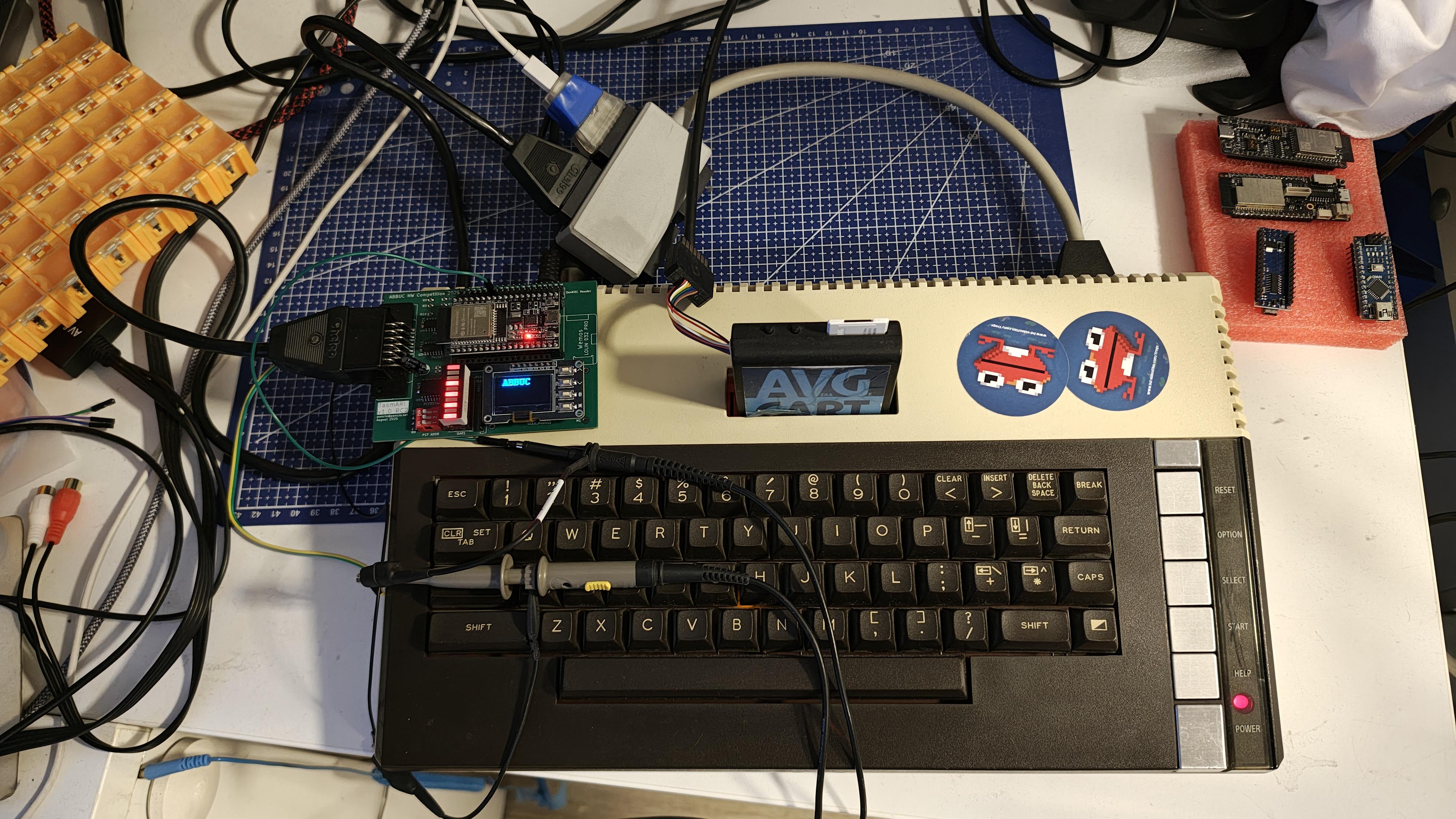

I've taken a break from my busy work and have some time to focus on what I really enjoy – the ATARI and its projects :-) So, I'm returning to the topic of TasmARI and will try to explain more about this device's capabilities. In short, TasmARI isn't just a simple Atari hardware with Tasota, but also a powerful support tool that can communicate with Atari via SIO. The main goal was and is to connect the Atari to Home Assistant, but sometimes more complicated things come up... like a very fast data transfer system between the ESP32-S3 and the Atari using synchronous data transmission, which in theory allows for data transfer speeds of up to 400 kb/s. Yes, you didn't expect 400 kb/s! How is that possible? I'll tell you another time :-)
Back to the topic of TasmARI. Those of you who have had a chance to follow the thread on my website: https://systemembedded.eu/viewtopic.php?t=72
You already know that sending data from an Atari to our IoT network isn't difficult, and receiving data through the Atari isn't a problem either. Of course, the examples I've shown are very simple, and to be completely successful, I lack a real message parser and program on the Atari side, but I hope that will change soon. Although I'm not a programmer, I might be able to put something together with the help of artificial intelligence... maybe someone would like to help and play with me?

I'm currently assembling the latest revision of TasmARI: v2.1RC4:
